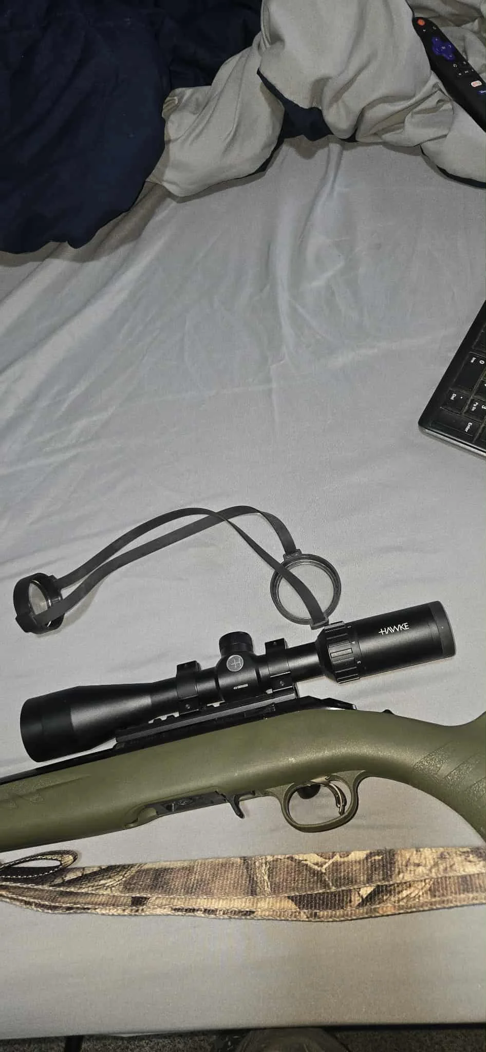

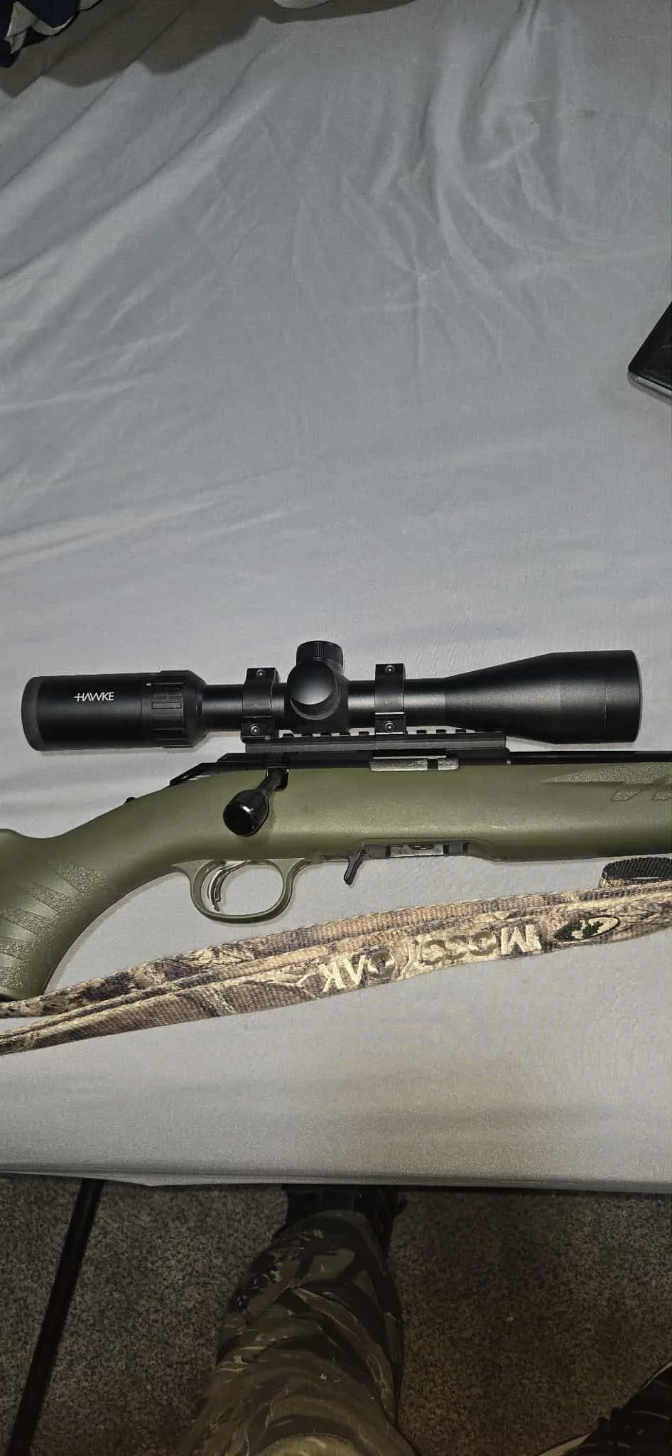

I was always a fan of Burris scopes but have traded them all out on my rifles for Hawke Optics, sharp image and seem to gather more lite than the Burris did. I found mine for $150-$200.
